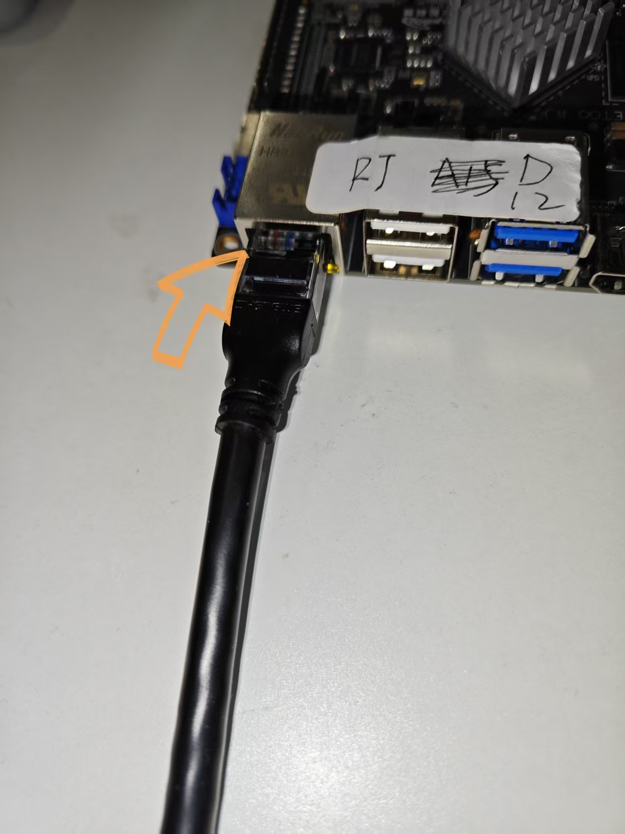

youyeetooRJ 支持 1 个 千兆网口(Ethernet0)
linaro@linaro-alip:~$ ifconfig
eth0 Link encap:Ethernet HWaddr de:37:22:3a:3a:66 Driver rk_gmac-dwmac
inet addr:192.168.1.88 Bcast:192.168.1.255 Mask:255.255.255.0
inet6 addr: fe80::dd17:4f39:704f:3306/64 Scope: Link
UP BROADCAST RUNNING MULTICAST MTU:1500 Metric:1
RX packets:2386 errors:0 dropped:0 overruns:0 frame:0
TX packets:65 errors:0 dropped:0 overruns:0 carrier:0
collisions:0 txqueuelen:1000
RX bytes:241522 TX bytes:6633
Interrupt:48
