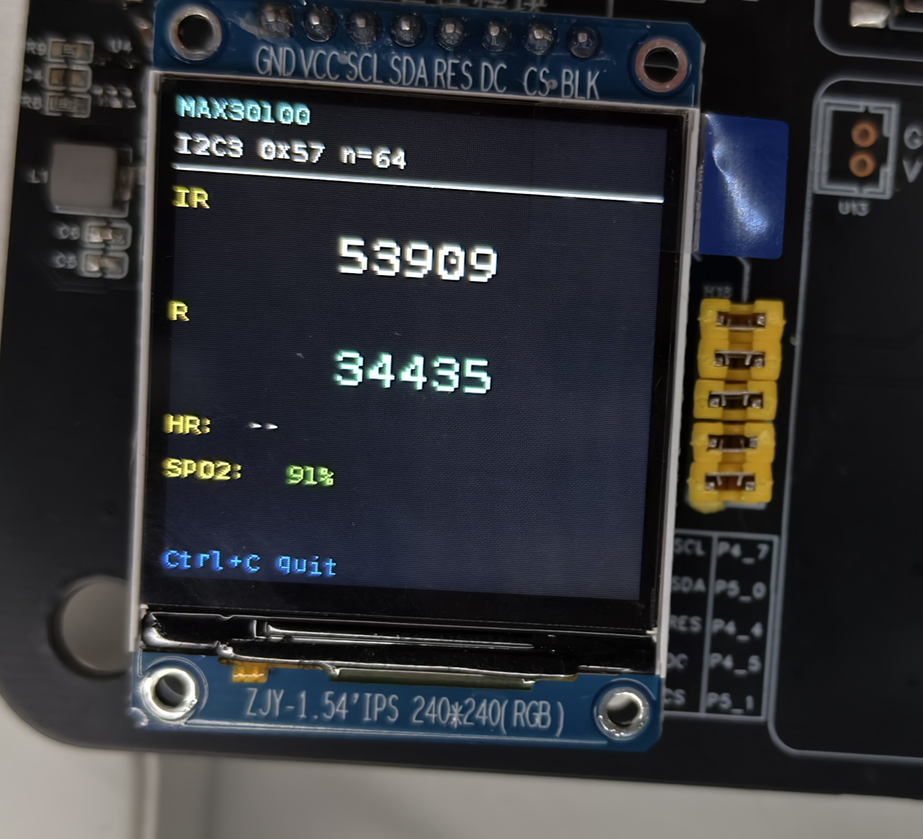

ssh root@<板端IP> '/usr/bin/spo2_sensor'
/mnt # ./spo2_sensor
[max] pad 复用:I2C3(4_1/4_2)->func2,GPIO4_4->func5
[max] pad 0x100C0010 -> 0x00001002
[max] pad 0x100C0014 -> 0x00001002
[max] 初始化 SPI 屏(/dev/spidev2.0)...
[spi] pad 0x100C0028 -> 0x00001004
[spi] pad 0x100C002C -> 0x00001004
[spi] pad 0x100C0030 -> 0x00001000
[spi] pad 0x100C0020 -> 0x00001005
[spi] pad 0x100C001C -> 0x00001005
[spi] opening /dev/spidev2.0 ...
[spi] spidev opened, fd=3
[spi] spidev mode/bits/speed set (MODE3/8b/24MHz)
[spi] chardev request DC @ /dev/gpiochip4 line 5 ...
[spi] chardev request RES @ /dev/gpiochip4 line 4 ...
[spi] chardev request CS @ /dev/gpiochip5 line 1 ...
[spi] chardev-verify: DC=0(expect0) RES=1(expect1) CS=1(expect1) ==> OK(chardev 真驱动了引脚)
[spi] spi_hal_init done
[tft] init: SLPOUT
[tft] init: SLPOUT +120ms ok
[tft] init: config cmds ok
[tft] init: DISPON
[tft] init: DISPON ok
[tft] init: clear-flush start
[tft] flush #1 start
[tft] flush #1 done
[tft] init: clear-flush done
[max] 初始化 MAX30100(/dev/i2c-3 addr 0x57)...
[max] PART_ID=0x11 REV_ID=0x05
[max] @ /dev/i2c-3 addr 0x57 (rev=0x05, INT=disabled, polling only)
[max] 采集中,50 SPS;采样线程 100ms/次,屏刷 200ms/次,Ctrl+C 退出。
